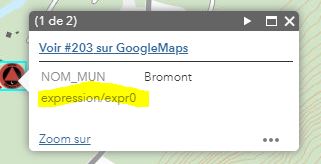

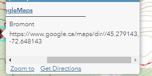

Hi everyone, I've wrote an expression with arcade in agol. The expression is a link to GoogleMap. So when you click on a feature it redirects you to a GoogleMap link with lat & lng issued from the geometry.
Here's the issue: when I deploy the application with WAB the expression no longer works and just displays the name:
No link From WAB:
Capture from the application
OK Link in arcGIS online:
Capture from the arcgis map

That is strange... It works just fine for me in both the Web Map and the Web AppBuilder:

So I' m using WebAPP Builder for Developper to construct the app locally and then I deploy it on my server. So, when I'm working locally on my computer, the link created is actually pointing on localhost instead of pointing to googleMap, Then when I upload the app on the server it points to the root of the app (where the index.html file is located). You will see that in the video.
