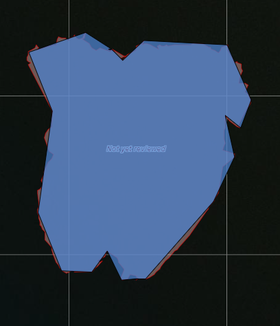

The issue: the Add Data widget, when uploading a zipped shapefile, way over-generalizes polygon features. See below:
You can see the 'real' version of the feature underneath it in red, and the 'Add Data' layer overlaid on top in blue. You can see how many vertices get dropped.

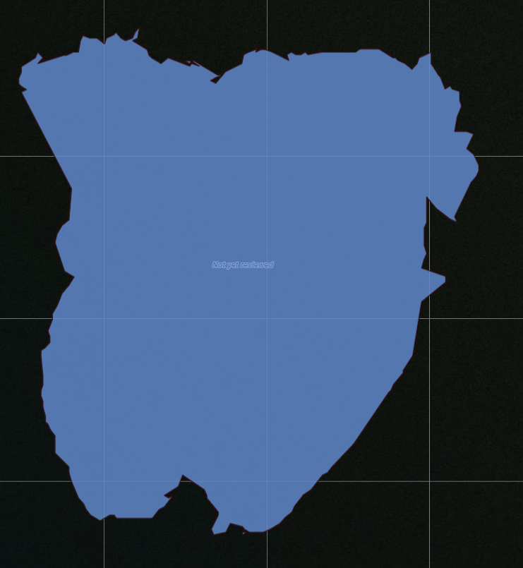

Contrast that with using the Add Data widget with a GeoJSON...
It also works equally well with using the widget with an existing feature service version of the data.

The only way it seems to be dropping vertices is through a zipped shapefile. This is quite problematic for our workflow, as most of our field staff will have data in shapefile format. I would rather not have to ask them to convert their data to another format, when the Add Data widget clearly accepts zipped shapefiles (and the rest of the AGOL platform seems to not have a problem with appending a zipped shapefile directly).

Definitely not a dumb question, as you're absolutely right. I didn't even notice the box existed....
Unchecking the box fixes the problem. A few odd things that threw me off, in case somebody else sees this....only shapefiles get generalized. You can have the box checked for any other form of data and it's not generalized. And the generalizing is not just for web display...if the feature is copied over from its generalized form that generalization is preserved.
