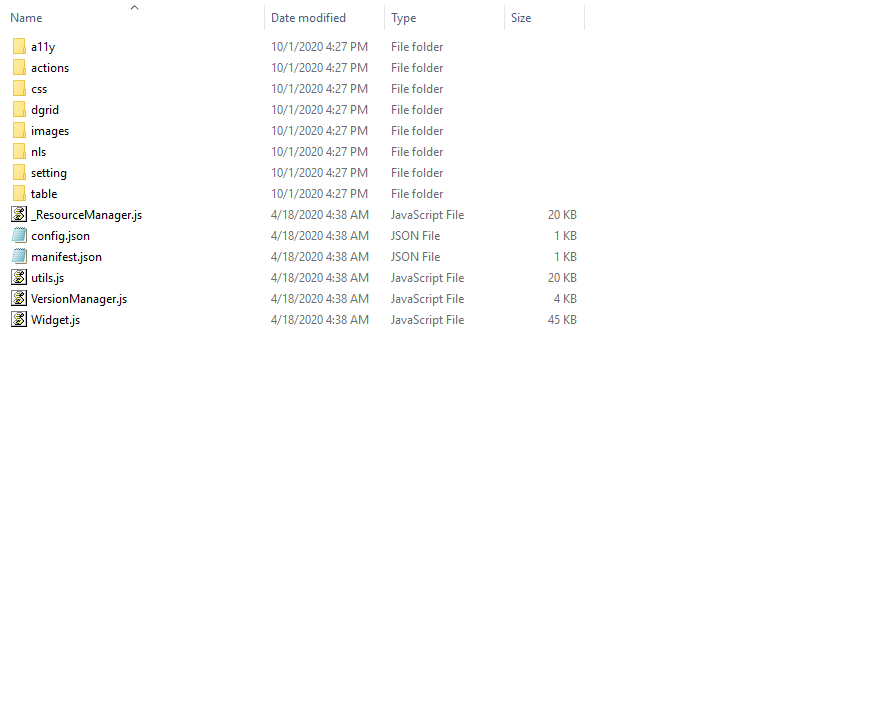

fahadrasheed
@RobertScheitlin__GISP  ,
I tried following the procedure mentioned above but couldn't found the  'PopupHandler.js' file in Attribute table widget. Also you mentioned that this procedure is for version 1.3 but i'm using version 2.16. I have added a screen shot of attribute table widget file.
Thankyou,
