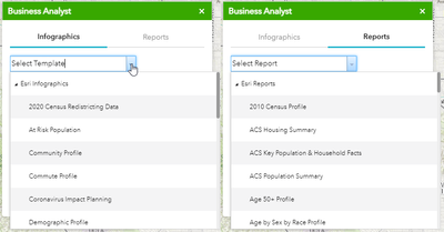

Esri Infographics and Reports
If you use only the default Esri infographics and reports, no additional action is required from you. These templates are automatically updated with the Esri 2022 vintage and you can continue to use them as usual.

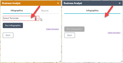

It is very important that go through the following migration and update workflow if you have created any custom infographics or reports. If you use shared infographics or reports, the owner of those templates should do the same. This action is required even if your templates contain your own data and no Esri data. If the migration and update is not complete, you will not see your custom infographics and reports listed under My/Shared Infographics/Reports.
Missing custom infographics and reports.pngMissing custom infographics and reports.png
If your app is previously configured with a default custom infographic or report, you might notice the missing template from the list.
Missing default custom infographics and reports.pngMissing default custom infographics and reports.png

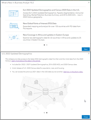

2. First you will see these welcome messages explaining what's new in this release. Please take a moment to read through these notes.

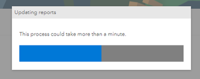

4. The Updating reports progress window is shown while the migration is underway. The process time will depend on the number of custom reports and infographics that you have.

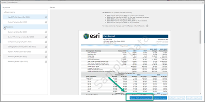

5. After the migration, you will see all your custom reports and infographics that require label updating. Click Update this & remaining reports button to update all labels at once.
6. You will see the Updating reports progress window again while your templates are being updated with the Esri 2022 labels.

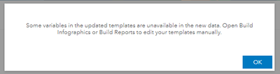

7. When the process is complete, you will see this final message. Your migrated/updated templates might contain variables that are no longer available in the Esri 2022 vintage. If that is the case, you will have to manually edit and update your templates. For more detailed instructions, check out this blog: Migrate custom Business Analyst content to 2022 Esri Demographics

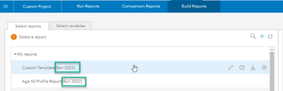

8. If you go to the Build Reports or Build Infographics workflows, you will see your templates are now migrated and contain (Esri 2022) in the names.

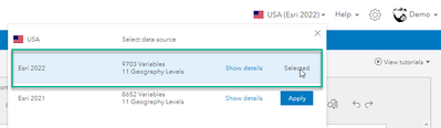

10. Going forward, just make sure to select the Esri 2022 data source before creating custom infographics and reports so that your templates are automatically available in the Business Analyst Widget for Web AppBuilder.
