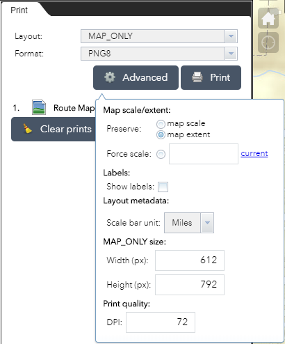

GarrettSeay2
I've found these setting have greatly increased my print speed with the widget.
Basically making it a format of PNG8, with a px width/height of standard letter paper and a DPI of 72 at the maps extent.
