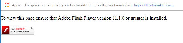

Do you get the Flash warning every time or just on the first opening after logging into the computer?
Maybe this registry key edit will allow me to open the flex app up against AGS 10.7 services on a Windows 2016 Server server.  Fingers crossed.

Do you and/or your colleagues get this message whenever you browse to your flexviewer apps when using Chrome when you first log into your computer?
MatthewFletcher
Yes, that's the same message we receive.

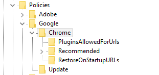

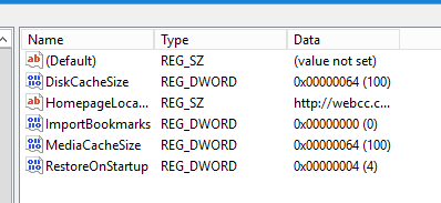

Rhett:
The is what the registry looks like on my machine:
I do not see a "DefaultPluginsSetting" key.  Do I need to add a new key or add a new value to the Chrome folder from the list of String value, Binary value, DWORD (32-bit) value, QWORD (64-bit) value, Multi-String value, or Expandable String value?

I had to add it as a DWORD.
Windows Registry Editor Version 5.00
[HKEY_LOCAL_MACHINE\SOFTWARE\Policies\Google]
[HKEY_LOCAL_MACHINE\SOFTWARE\Policies\Google\Chrome]
"DefaultPluginsSetting"=dword:00000001
@="1"
I find the easiest way it to just copy/paste the above text into a text file and save with reg extension (filename.reg).
then just double click it and it will prompt to create the entries for you.
