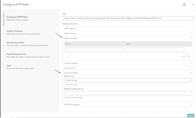

I am trying to build a new FEED that will Poll a target for data.  I would like to use the URL Parameters capability to add &date=2024-03-15  where the date should be the current date - one.  Can I do that?  Where is the documentation for this and other features like Global Parameters?

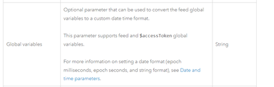

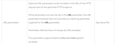

    I read that a dozen times before I posted --  Under Parameters - URL parameters - It really does not tell me what global variables might be available as a value in the key-value pair.   I need $yesterday or $today-1 to complete the URL parameter &date=yyyy-MM-dd (edited).   Additionally, noting tells me how to determine which value of the key value pair Global variables (An optional parameter that can be used to convert the feed global variables to a custom date time format.) is applied to.
Finally, while $accessToken is referred to a number of times on this page there is no explanation as to whether it's an oAuth or API access Token.  Or how to utilize it.

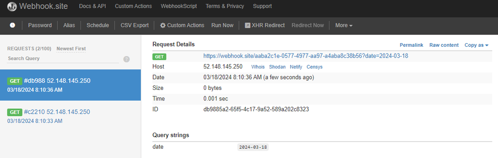

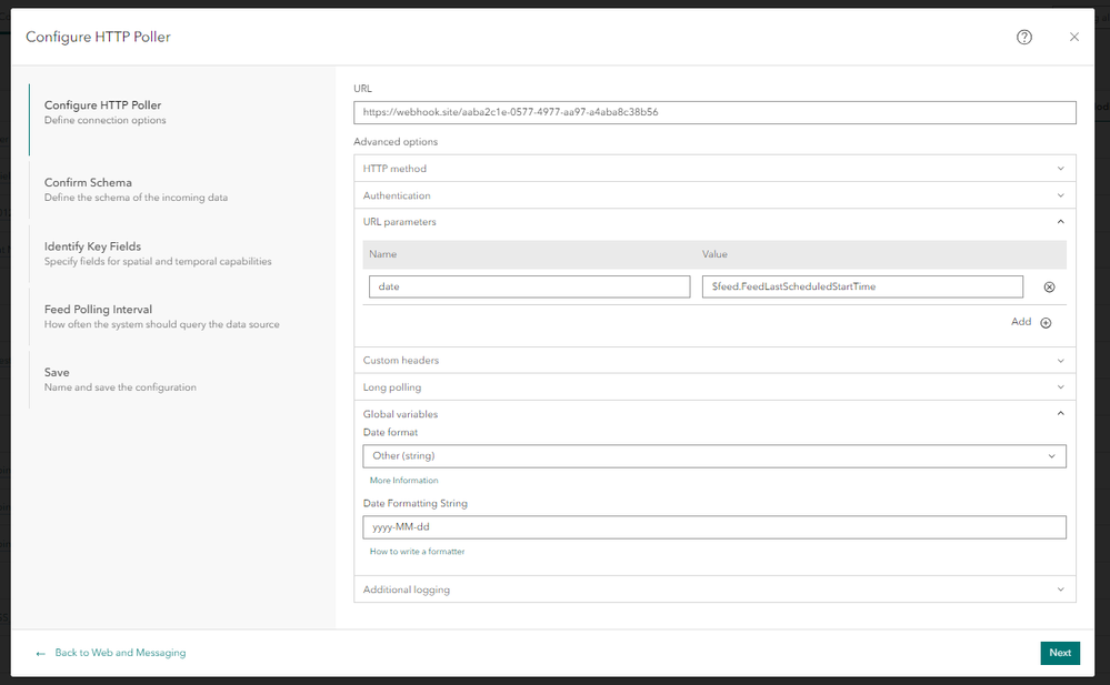

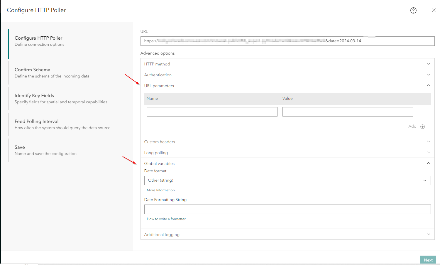

I hooked up a quick example with screenshots below of what this configuration would look like to reference the FeedLastScheduledStartTime global variable:
Configuration:
Result:

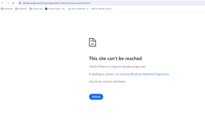

@PeterNasuti  -- The url for these links, do not resolve -- docdev.arcgis.com  did I miss something?
PeterNasuti
Thanks @JeffSilberberg I updated the links

Okay I set the Global variable an got a default 1970-01-01 data instead of yesterday --
{"mode":"xml","date":"$feed.FeedLastScheduledStartTime","resort":"XXXXXXXXX"}
So the Poll failed again today.
