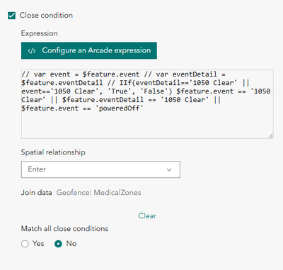

JeffSilberberg
Thank you!
One follow-up question. If the Detect Incidents Close (exit) condition is based on an Arcade or a Spatial Condition and the Arcade condition is TRUE, does the node still try to use the Spatial Condition?
