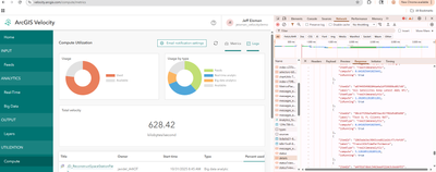

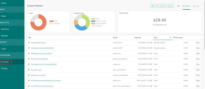

You are correct that swagger will only show the items that you own, at this time there is no out of the box way to generate a list of the status of all the items in a velocity org.  You can see them on the UI  if you are a admin though.
The way to do that is login as a admin and go to the Utilization tab on the left hand side of the page and under compute you will see a list of all running items.
From that page you could look at the network traffic and under Details and see a list as well
We are looking into possible future enhancements to monitor velocity in more detail

JeffSilberberg
Okay,
   Not very user-friendly, but I do see that information. Interestingly, the Page includes the object's owner, but looking at the detail and status JSON buckets, I do not see the object owner included.

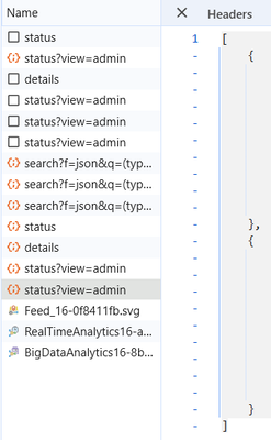

    Details has the Feed infomation, if I am looking at this correctly, and Status the RTAs/BDAs. But, what's the difference in the three status?view=admin sections?

PeterNasuti
@JeffSilberberg The Velocity UI uses that call to collect feed/analytic item status of all items of that type in the Velocity org. Then it does an ArcGIS Online content search "/sharing/rest/search" with structure such as:
https://arcgis.com/sharing/rest/search?f=json&q=(type: "Real Time Analytic") AND (orgid: <yourOrgID>)&num=100&start=0&sortField=title&sortOrder=descending&token=<yourToken> and joins the owner name from matching the item ID.
