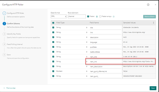

Thanks for providing the additional information. The Public URL in XML format can be brought into a HTTP Poller feed.
https://www.511virginia.org/mobile/data/RSS/StatewideIncident.xml
For this feed you can flatten and use channel as the root to get down to a usable schema. The geometry is still nested in the item-link field and looks like this
 “ http://www.511virginia.org/?lon1=-77.462688&lat1=37.5759&lon2=-77.462688&lat2=37.5759”
It will need to be calculated in a Real Time analytic to pull the Latitude and Longitude.

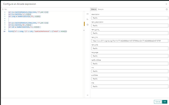

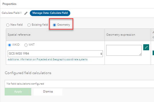

In the Calculate Field tool
- Add new Geometry field
Use an arcade expression to calculate Geometry
var a = Split($feature.item_link, '?',10 ) [1]
var b = Split(a,'=', 5)[1]
var Long = Number(Split(b,'&', 2)[0])
var b = Split(a,'&', 5)[1]
var Lat = Number(Split(b,'=', 2)[1])
Point({"x" : Long, "y" : Lat, "spatialReference" : {"wkid" : 4326}})
Let me know if you have any other questions
