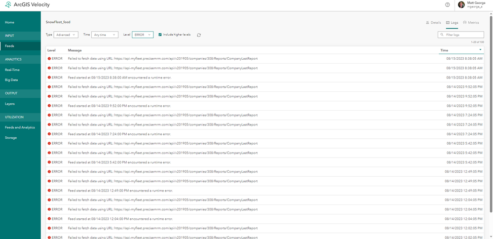

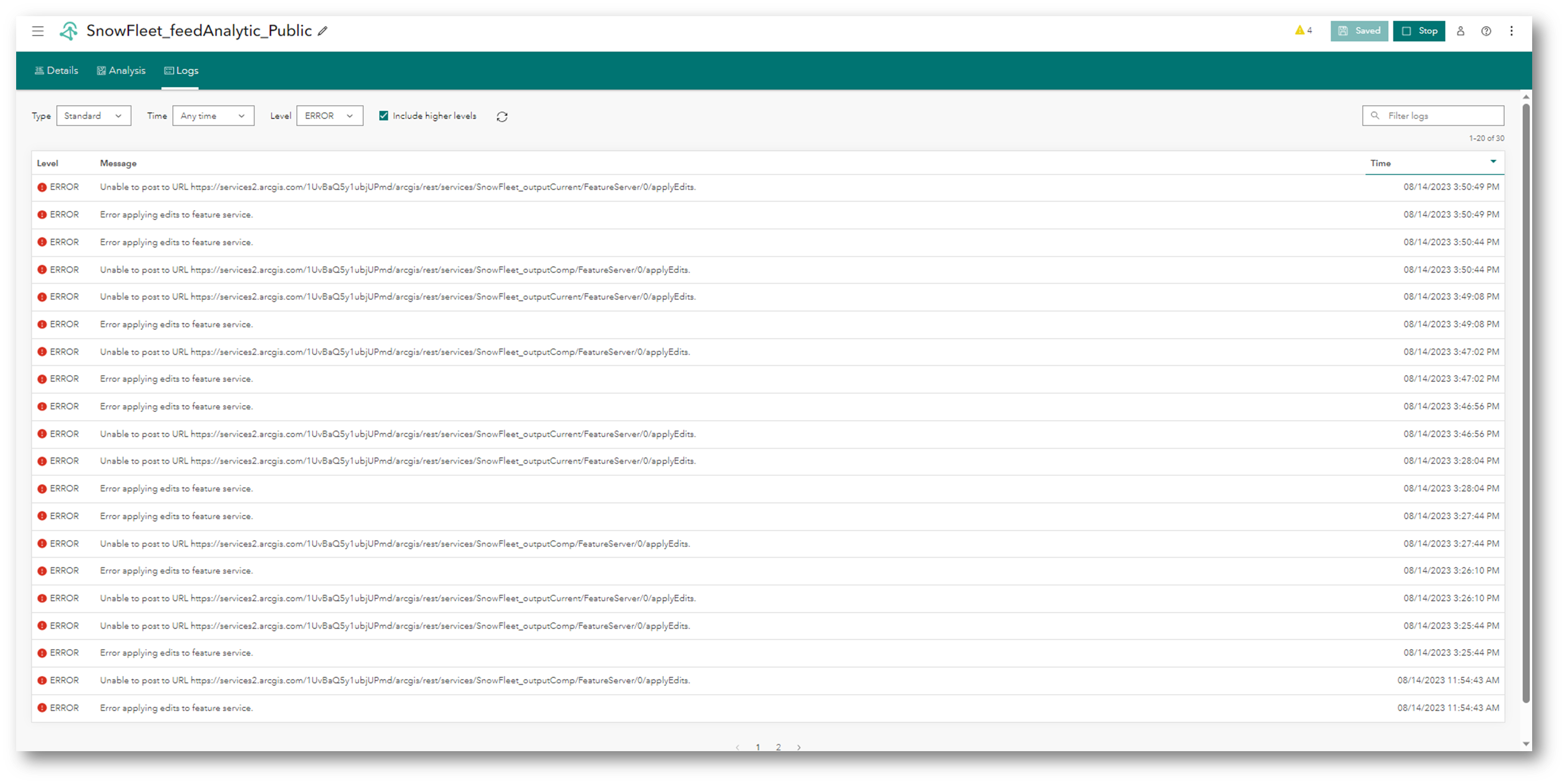

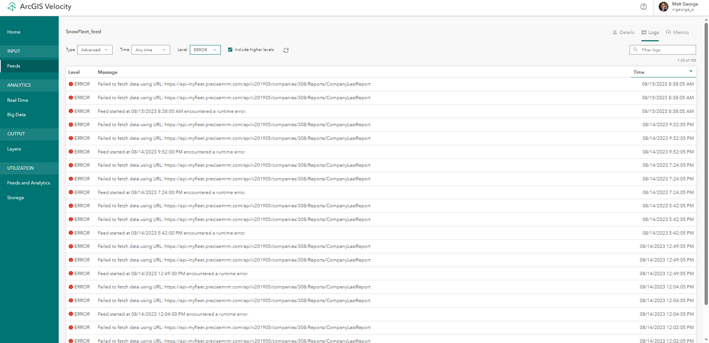

Errors I’m seeing: Feed and Realtime analytic.

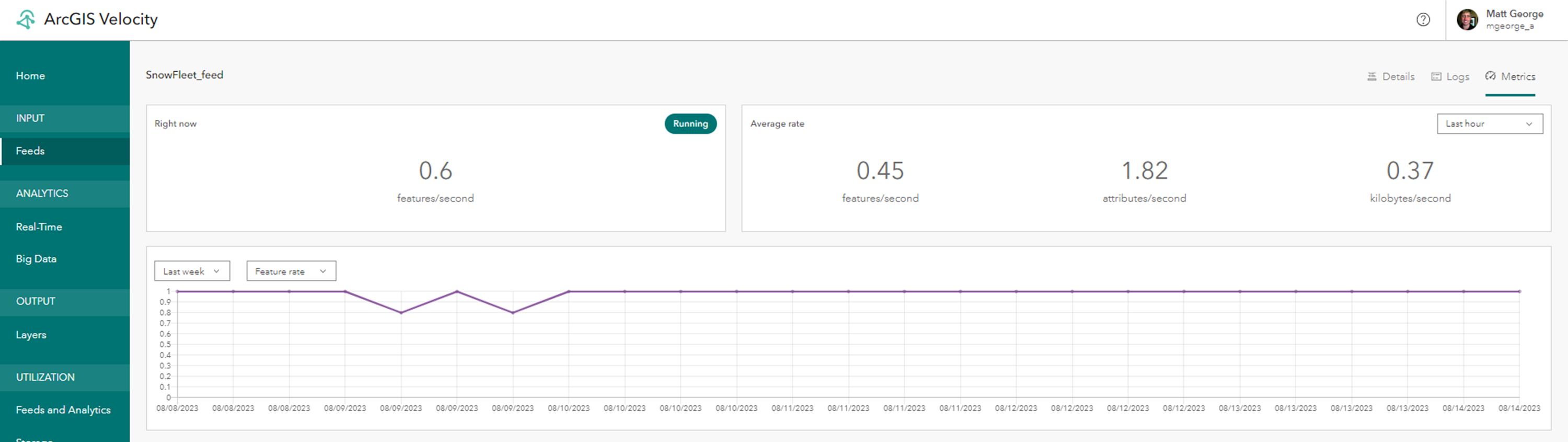

Feed:  The feed is running at 0.4f/s with 1.75 on avg attributes/second.  The feed ingests 54 total public works fleet trucks.  I understand Velocity recommends no more than 2 events per second when running non spatiotemporal workflows.  The recommendation or limitation is governed by our bronze level Velocity subscriptions at the 20K per year price point.  At first, I thought maybe I’m ingesting too many attributes/features but I’m below the threshold, so I think that’s ruled out.
FEED SCREENSHOTS:

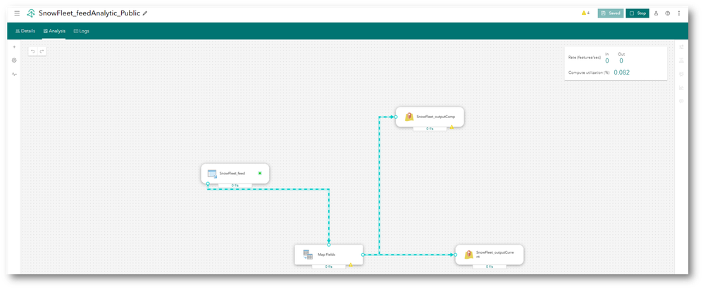

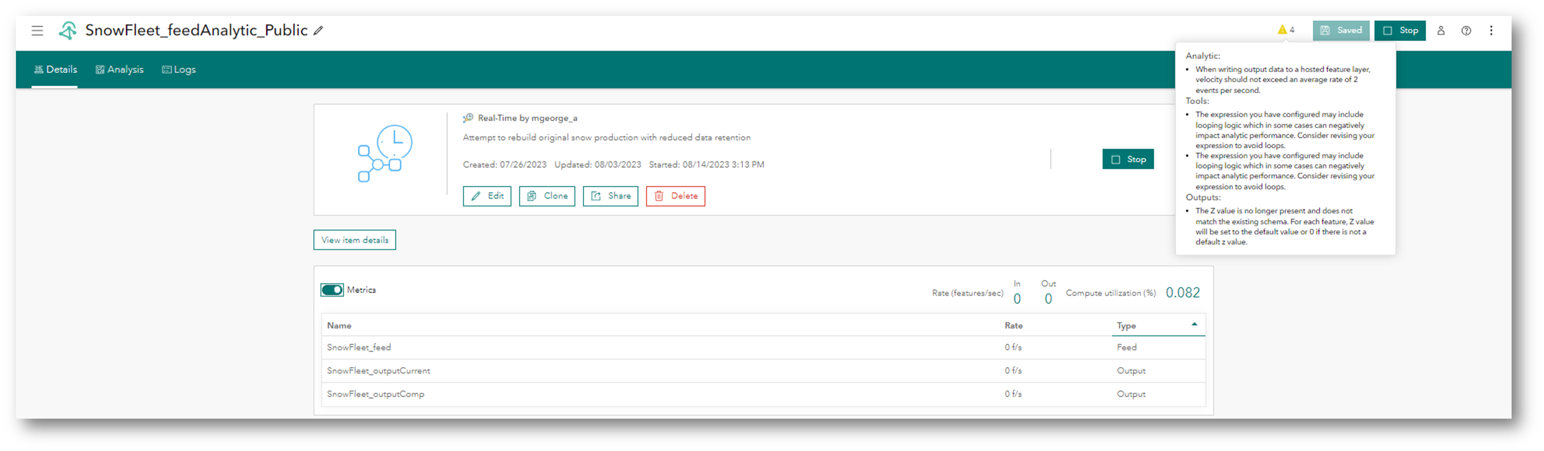

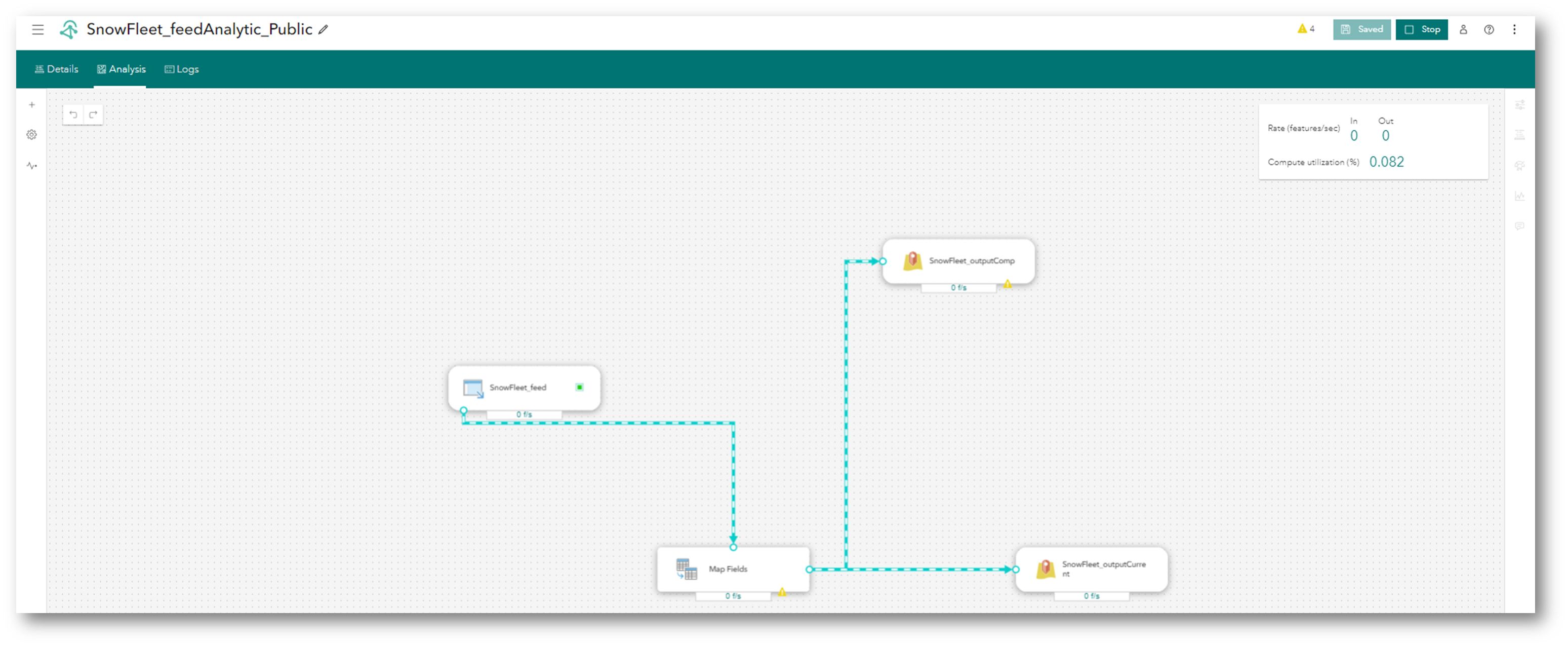

REALTIME ANALTYIC SCREENSHOTS BELOW:
FEATURE SERVICE OUTPUTS
The top FS output SnowFleet_outputComp is setup for Keep existing features and schema with add all new features, False for spatiotemporal feature layer.
The bottom FS output SnowFleet_outputCurrent is setup for Replace existing features and schema, keep only the latest feature for each Track ID value and again false for spatiotemporal.

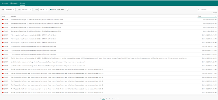

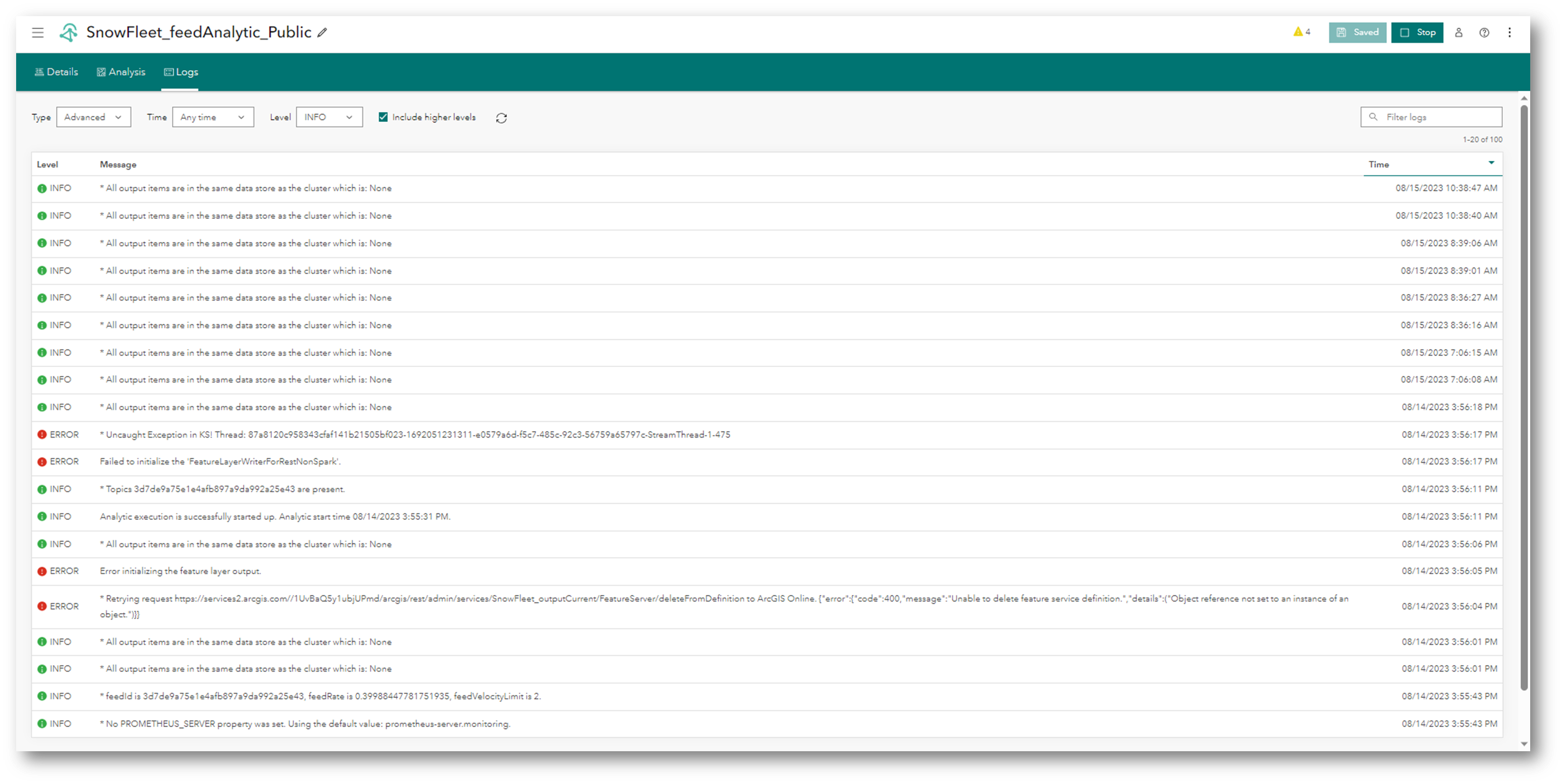

Advanced error logs:

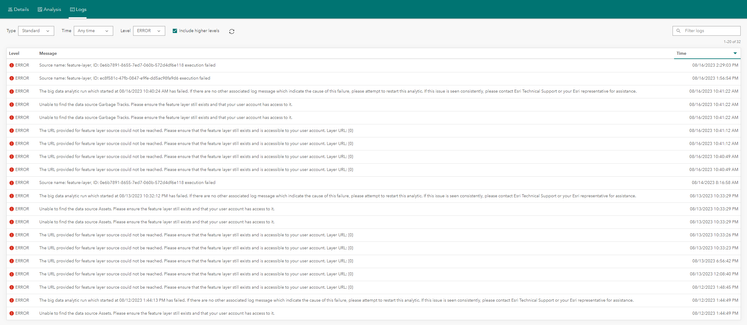

Standard error logs:

@MattGeorge1 Today, as an example, we noticed that our data had gaps.  Velocity was gathering information/vehicle tracks normally in the Realtime analytic.  When I looked at the map and the output from the associated BDA, there were data gaps during the day.  The BDA was working fine and updating statuses on the map when criteria was met, then there was a two hour stretch when it wasn't done.  There were no errors in logs during this time and the BDA continued to run.  After this stretch, there was an hour stretch where it began working again.  Finally, there was again an hour stretch where it didn't process/change the status field...
What I am guessing the issue could be for us, is that we have had errors that our BDA can't locate our vehicle tracks hosted feature layer that was created as an output in the Realtime Analytic. So, therefore; when it can't find the vehicle tracks, it can't run our BDA correctly during those time.
