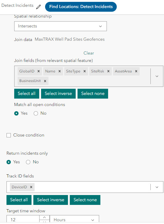

I have come across some outlier cases where a driver has visited multiple well pad sites over the course of a timespan recorded over few hours. However it seems that the all these events are recorded under a single Incident ID. This should never happen since each well pad site visited should be logged under a unique incident ID. Below is my analytic -

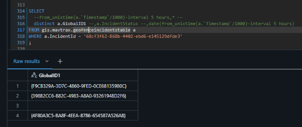

Here is one example where 4 different Site IDs are logged under a single Incident ID, I would expect to see all these occurrence's under 4 different Incident IDs.

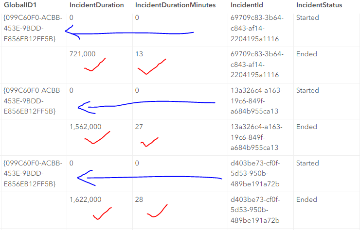

Majority of incidents are closed when vehicle exits the geofence and a single Geofence ID is associated with the incident as expected. Here are several good examples below -

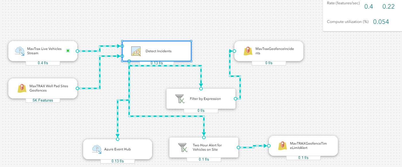

@MuneerMajid The first question that comes to mind is, "How fast are the vehicles reporting their locations?" The image shows a feature ingestion rate of 0.4 f/s which is petty slow. Thus if a vehicle reports its location while on a pad, Detect Incidents should observe an 'intersects' and open an incident. The implicit closing condition of 'intersects' is 'disjoint', so if the vehicle subsequently moves to a second pad before it has a chance to update its location and is on that 2nd pad when it updates its position, Detect Incidents once again will detect an 'intersects' with no intervening 'disjoint'. Therefore it will not close the incident but emit an OnGoing status. If you have control of the vehicle reporting interval, you might try to increase that. That way you will get more granular position updates and a better chance of detecting changes in spatial relationships.

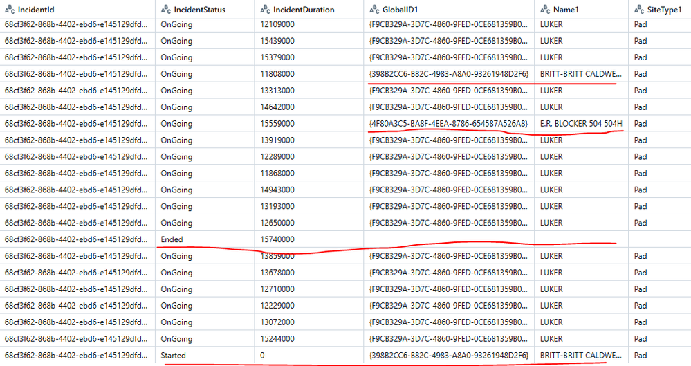

You are correct in stating that the other polygons were logged under the 'Ongoing' state with the same Incident ID. This table shows exactly that and you can see that the observation under this incident are quite muddied because of the 3 geofence polygons involved -
