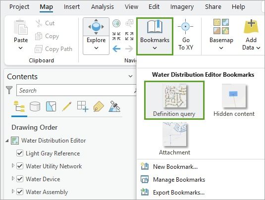

In Configure filters for the subtype group layer,  Set definition queries. I do not see in my ArcGIs Pro  the option "Definition Query" "On the ribbon, click the Map tab. In the Navigate group, click Bookmarks and choose the Definition query bookmark."
Where can I find it?

He appears to be looking for it in the training data from learn.arcgis.com.  I am guessing to complete the class, he may need to scroll around the map to find the area being worked on.
RobertKrisher

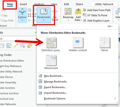

I just downloaded the sample data from the lesson and verified that the included map does include the bookmark from the tutorial:
The location pictured in the lesson is in the northwest corner of the service territory at 1,028,097.13E 1,867,343.62N ftUS
