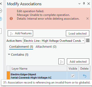

Hi,
An Electric Line feature has made it into our default Utility Network.  The line feature cannot be deleted because it has an association, contains an Electric Edge Object.  The association cannot be removed because of an error "31: Association record is referencing an invalid from or to globalid".  This sounds like an issue related to the line feature having zero geometry.
Is there a way I can remove the association or delete the line or remove the association?

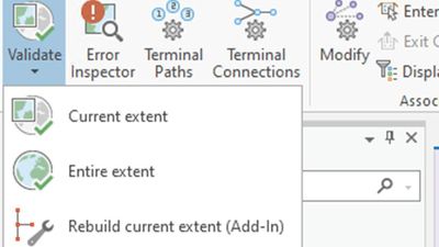

Do you have a dirty area in the error inspector?
Was there a import of associations or records OR was it managed through ArcGIS Pro?
The Rebuild Network may help but I am not too sure at this point.

I cannot delete the association through arc pro or through the feature service.  I believe the error was posted from a version in arc pro during an upgrade.  the error inspector is giving me the same error 31

I see there is a line and 2 edge objects. Rather than delete the association, could you try deleting the objects themselves?
