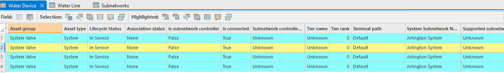

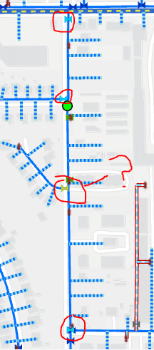

To be clear, the yellow highlighted valve is what I've selected in the map. It's a System / System valve, not a System / Bypass valve (similar yellow in legend). It's yellow because I highlighted it. All 4 valves are identical in terms of attributes that matter for UN connectivity and tracing. There is nothing special about this one valve, it's like many others. The lines on either side show z-values of 0 as well. I cannot find anything unusual about this random little area.

That valve is not required to isolate the area from pressure, which is why it was not selected. During a shutdown, the field crew may choose to close it to prevent draining the area, but that is an operational decision, not an isolation requirement.
It is an isolated valve, not an isolating valve.

Ok, that picture helps.  That valve is isolated by closing the other valves.  So to isolate that area, that valve going into the cul-de-sac does not need to be closed.  Now field operations, might choose to close that value, so the pipe is not drained and then does not have to be disinfected.  But that valve is not required to be closed to isolate the area.
