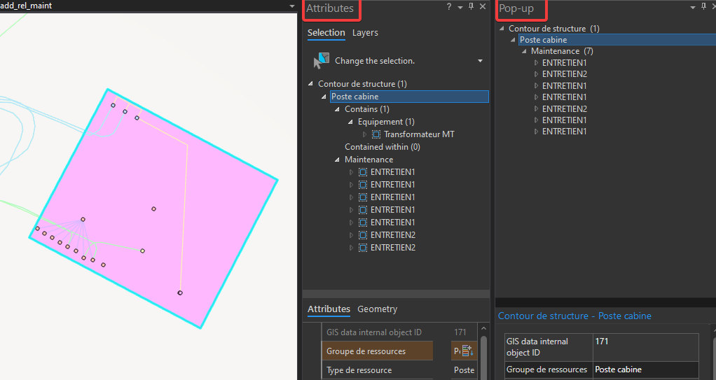

Is it possible to view UN associated features (from a utility association) the same way we view related records (from a relationship class) in the feature popup ?
By now, if I open the popup of an object with a relationship class and also with UN association, I only see the relationship and not the association. But if I select this object and show the attribute pane, I can see both.
Is it possible, or is it in the roadmap ?

I believe you can configure a pop-up using Arcade Expression and FeatureSetByAssociation function. Also see this blog by @HusseinNasser2
But I agree, it will be nice if popup shows nodes for UN relationships such as "Connected", "Contained By", "Contains", "Associates" etc. without Arcade expression if UN Device/Line/Junction/Assembly is popped up.
