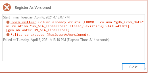

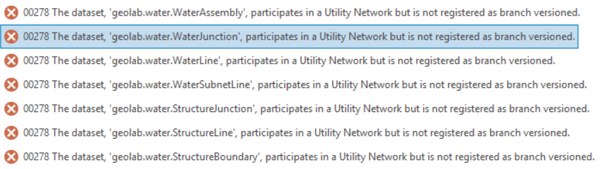

We ran the utility network data set in enterprise geodatabase (PostgreSQL 9.6). To make the utility network feature-featured service, we get the warning that the data you site is not versioned (first visual). When we make the data set in the utility network register as versioned from the catalogview screen, we get the error in the second visual.
Have you encountered such a problem before?

@YağmurSoydan , you are getting this error because the data is not branched versioned.
There are two types of versioning: Traditional and Branched.
The utility network requires the data to be in branch versioning. Double check to see whether this has been set correctly.
https://pro.arcgis.com/en/pro-app/latest/help/data/geodatabases/overview/register-a-dataset-as-branc...

Be sure your connection to the data is set to 'Branch Versioned'.  R-click on the connection and go to Geodatabase Connection Properties.
