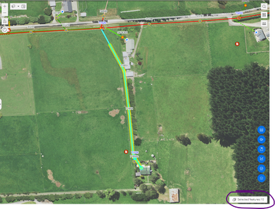

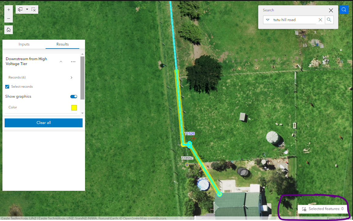

Facing a situation where the trace widget isn't working as expected when selecting results.
Here is an example of it not working i.e not selecting any records. They are highlighted blue. It also shows in the trace widget results tab that it has select the records.
The problem this causes is the devices are not selected in the table widget.

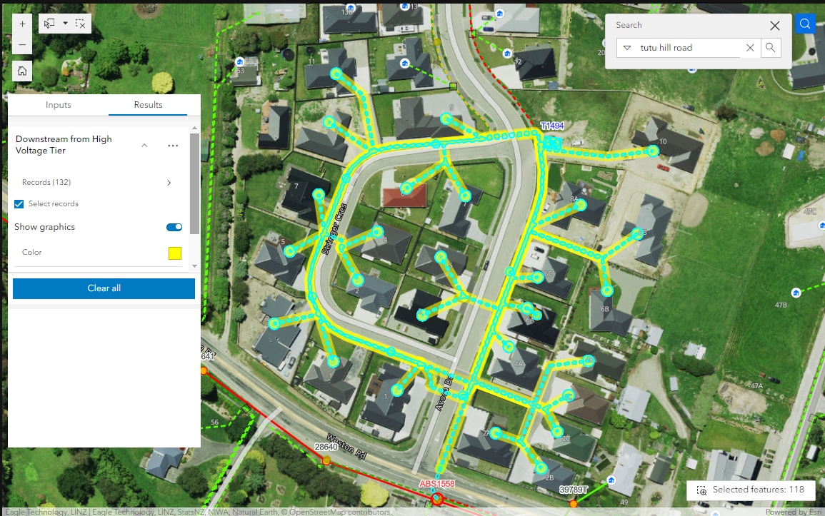

Weirdly it works when I trace from the transformer
another area where it works -

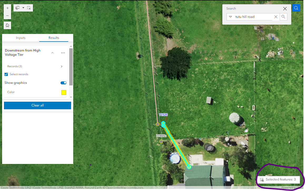

This is being looked into by ESRI.
2 workarounds at the moment -
1)  Configure the trace to only output the feature layer that is connected to the table widget
2) Remove any definition filters on layers on the map.
I have gone with the second one and it works.

In the mean time we have been provided with a workaround.
"...current work around provided for this issue is: Configure the trace to only output the feature layer that is connected to the table widget...."
I have tried that and it works fine.
