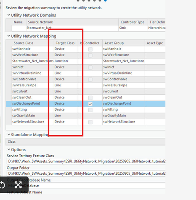

Hello,
Upgraded to Pro ver 3.5.2...  Just tried the tutorial "Utility network migration wizard walkthrough" (https://www.esri.com/arcgis-blog/products/utility-network/water/utility-network-migration-wizard).  I chose stormwater ("sink" as controller type, "hierarchical" as tier definition); chose asset types the same as the tutorial screenshot -  although the chosen asset types didn't show up in the summary.  My service territory FC is the only thing I added from my existing data.
When I clicked "Finish", I immediately saw "Error 00800: The value is not a member of StructureJunction | StructureLine | StructureBoundary | SinkDevice | SinkJunction | SinkLine." When I closed the error window, "Migrating" window was still running, but disappeared after 2 seconds or so.
Anyone experiencing the same issue, or could explain what I did wrong? Greatly appreciate help!

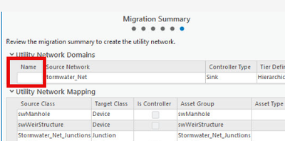

MichaelHirschheimer
Hi @NobukoConroy_BFS
I've gotten the same error when the "Name" field was left blank.  Go thru the steps again and make sure that field is populated.
RobertKrisher
Step 4 of the article says that you must populate the Name, Source Type, and Tier Definition. The issue is that there is a bug (that we're waiting to patch) that lets you proceed to the next page without populating the Name field on the domain network.
I have added a note to the article that explicitly reinforces this, along with suggestions for the domain network name to use in each example.

gis_KIWI4
MVP Regular Contributor
@NobukoConroy_BFS - The target class needs to one of the values highlighted in the error. StructureJunction | StructureLine | StructureBoundary | SinkDevice | SinkJunction | SinkLine
It's failing to recognize the values of "Device" etc where it is expecting the value to be "SinkDevice"

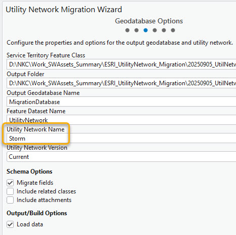

NobukoConroy_BFS
Thank you gis_KIWI4! I guess that part was not clearly explained in the blog.  FFYI for those who follow the blog, type your Utility Network Name as "Storm" (for stormwater), then the Target Classes appear as "Storm---".
MichaelHirschheimer
NobukoConroy_BFS
Thank you MichaelHirschheimer! I typed the name "Storm" (for my stormwater network), then Target Classes  worked (as advised by gis_KIWI4). Both of you made my day!
RobertKrisher
