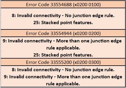

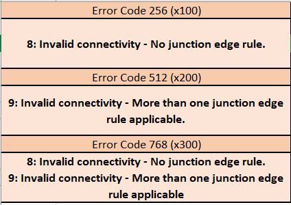

When we analyze Dirty Areas, besides checking the Error(s) field of the polygon in a pop-up (for example... 9: Invalid connectivity - More than one junction edge rule applicable.) we also focus our attention on the Error Code. This field, seemingly a bit-wise code, provides additional information that helps us analyze the error. For example, Error Codes 256, 512 and 768 (x100, x200 and x300) are all three about Invalid Connectivity, but with slightly different "flavors":

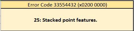

Although not limited to this use case, we found this technique particularly useful when analyzing the results of a migration. Change the default symbology of the Dirty Areas to be driven by Unique Value Error Code and show its count as well. Represent the Error Code in its hexadecimal format and you start seeing the patterns as the bits shift left. Another example? Stacked Points, or the x0200 hhhh series:
JoaquinMadrid1
Oops, I just noticed that in the last example, Stacked Points, I forgot to add the first of the "series":
