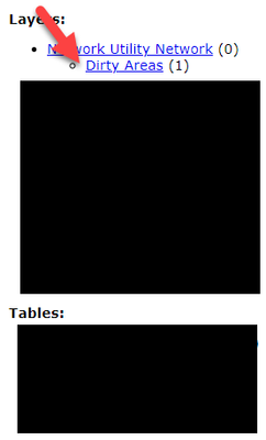

RobertKrisher
It is a layer, like any other in your feature service. Look at your feature service, get its layer id, and use the query method to find dirty areas with a status value that indicates they need to be validated.
