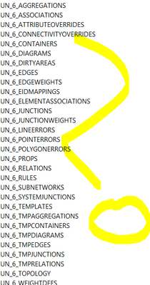

This appears to be a miss in logging on Esri's part:
The operation was attempted on an empty geometry.
Yet the message doesn't identify which (if any) tables has the empty geometry. And really not sure which 1 within the UN table set would cause the issue:

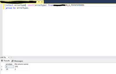

You can identify empty geometry within the UN by reviewing the point errors table.  Features with empty geometry will generate an error with the ID =1 when the network topology is enabled.  These can also be visualized at the lower left-hand corner of the UN's Service Territory.   Once identified, you should then be able to use the Origin Network Source ID and Origin Global ID to identify the class and record that caused the error.
geonexusjames
Hi Jonathan,
Thanks for the reply. This is good information. I've looked into the table's errortype and found 2 error types; 2 and 25. The description for 25 says 'stacked point'. Should I assume this is causing the issue? If so, will address these and attempt the Upgrade Dataset tool again.

You should see errors with errortype = 1 with a message of: "The geometry for the network feature is empty." if these are preset in your UN.
I tested a similar case on my end and was unable to reproduce this behavior.  I found that I was able to successfully upgrade a UN dataset from v3 to v4 on 2.6.3 with empty geometry records in one of my network classes.
