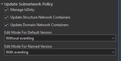

Are you doing this in a named version or default? What are the edit mode configurations for the subnetwork definition for the subnetwork you're updating?

This happend both in default and named version
