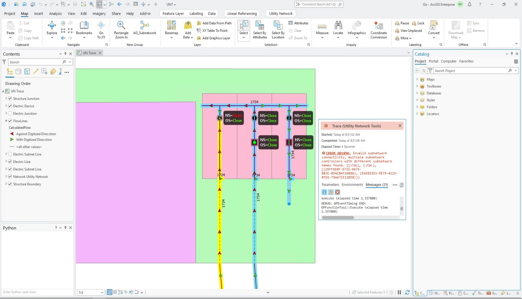

The trace starts within the Blue subnetwork (1734).
It then transitions into the Yellow subnetwork (1724).
If there is a device ahead with OS = Open, the trace correctly stops at that device.The tracing changes from the blue line to the yellow line, and the tracing process stops at OS=Open.
However, if there is no device with OS = Open ahead and the trace encounters the Yellow Subnetwork Controller, the trace fails with:
ERROR 001890: Invalid subnetwork connectivity, multiple subnetwork controllers with different subnetwork names found.

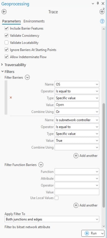

I also tried adding a Filter Barrier:
Is Subnetwork Controller = True
However, the trace still returns the same error instead of stopping at the controller.

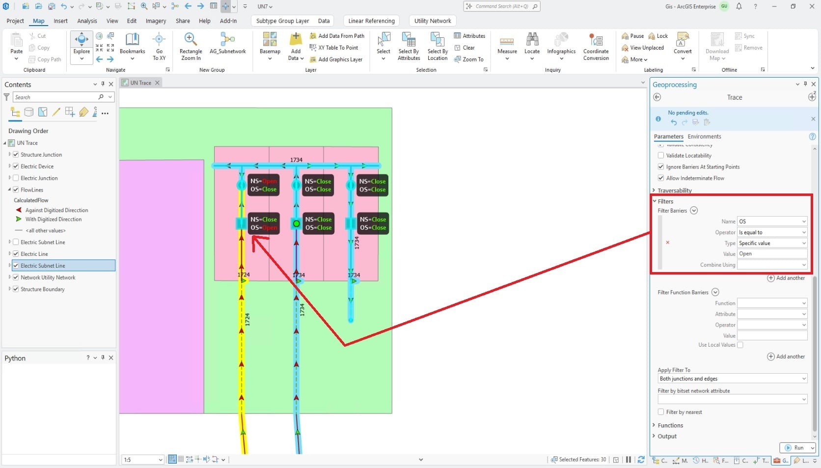

Yes, the device is energized from both directions, and with the current configuration I am able to continue the trace from the Blue line into the Yellow line.
The issue occurs only when there is no device on the Yellow line with OS = Open ahead.
In that case, the downstream trace continues all the way to the Yellow subnetwork’s Subnetwork Controller, and at that point the trace fails with the error. 
