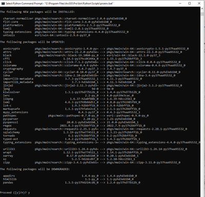

Just installed a fresh version of 2.9.6 to test in the older version of Pro and was only having untools 2.8.0 or older as an option.
Running the above command listed what packages needed to be updated/downgraded/installed. Worked like a charm thanks.

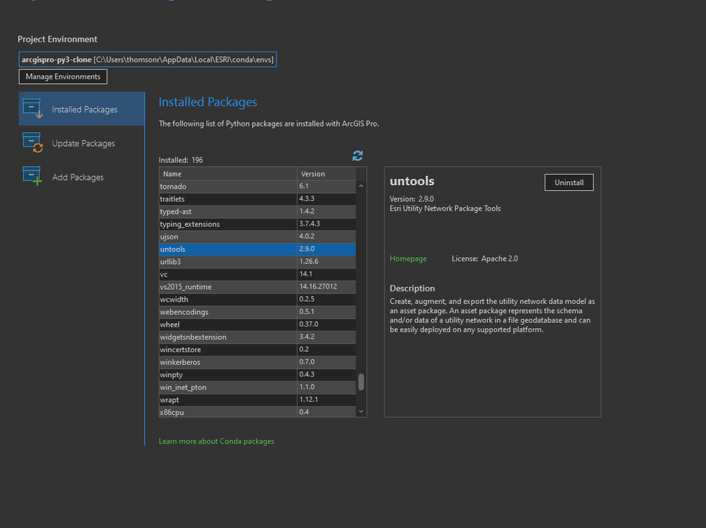

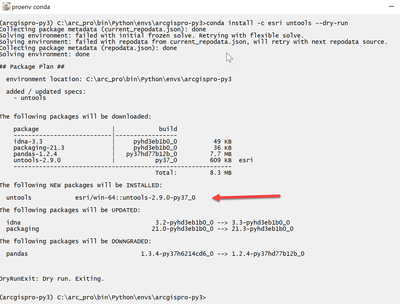

or to have a look-see at what else will happen during an install, here is the conda route... --dry-run is always a good idea at first, remove it if you are satisfied
