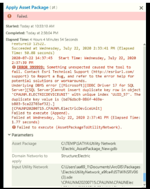

Is anyone can help with this error, we are getting continuously this error when we processed with our data.

It appears you have features with the same global id in the device unit table.
Starting with 2.5, you can use Asset Package to File Geodatabase to create a file geodatabase based utility network from the asset package.
