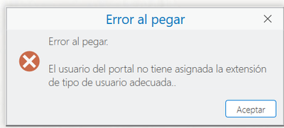

I tried to copy paste but I got the following message:
It is in Spanish but it says error when pasting the portal user does not have the correct type of extension assigned.

You do not have permissions.  What type of user are you.  What version of enterprise?  You need to ensure you have the correct capabilities.
GeoMon
Whats type of permit should I have? I Have enterprise 11.3 and arcgis pro 3.5. The utility was edited with professional advanced editing. The enterprise corporative was created with data schema other than ODE o SDE and was not branch versioned
