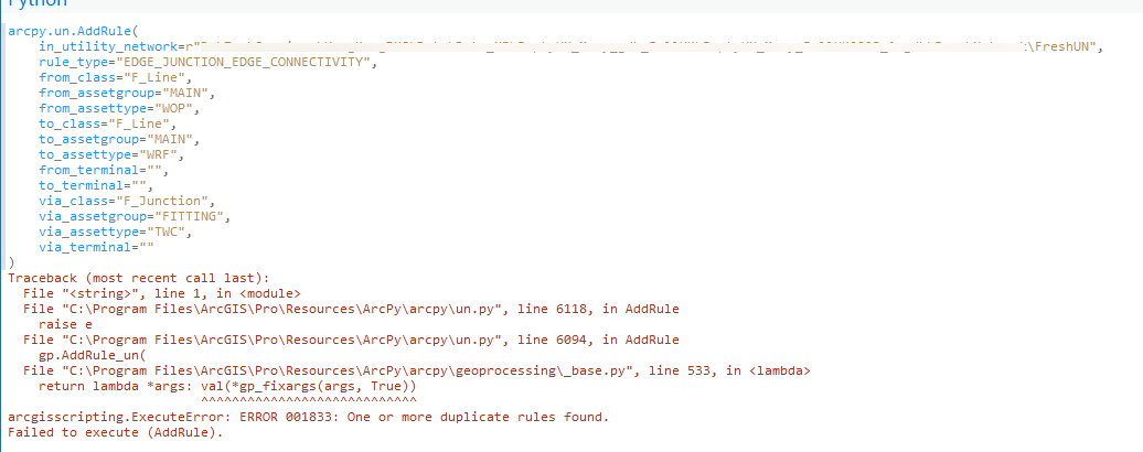

     I am working on adding connectivity rules to an empty Utility Network DataSet. I found that might have some error.

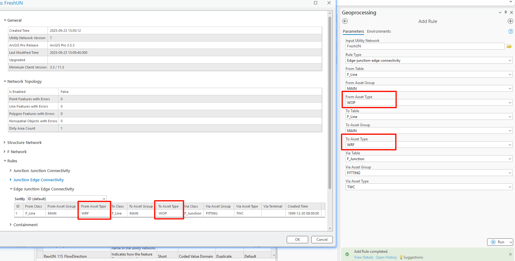

     I used the Add Rule Tools to Add the first connectivity rules into UN Dataset, after successfully add the rule, I found that in the UN Propertity,  the rule's FROM ASSET TYPE and TO ASSET TYPE is exchanged.
      Then I used arcpy to add the same connectivity rule to UN Dataset, error comes that the rule is existing.
     What's reason about that?   I appreciate any help with this.

I do not know why it swap it, but it does not matter.  EJE the order of edges do not matter.

The order of the from/to edges doesn't matter, so because you've added the rule to the UN using the GP tool it will fail when you attempt to create a duplicate rule using Python. If you add a new rule using Python it will work.
Finally, if you have many rules you need to add you should consider creating a CSV defining all of them then using the Import rules tool to import them all at once.
