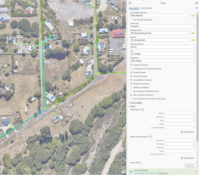

Hi,
Just wondering if anyone has noticed this issue.
Adding a filter barrier when tracing across tiers doesn't show any selection and trace tool suggests "Trace Completed"

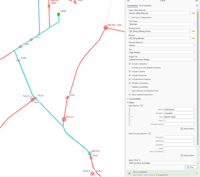

Trace without filter barrier - Runs fine. Selection returned.
Trace with a filter barrier - No selection. I have also tested other result types connectivity and aggregated geometry but they contain nothing either.

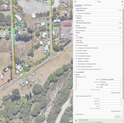

Trace with a filter barrier within same tier - Works as expected.
