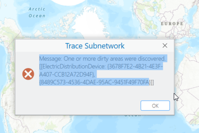

ArcGIS 2.7.4 Error – globalid is selected and available to copy.

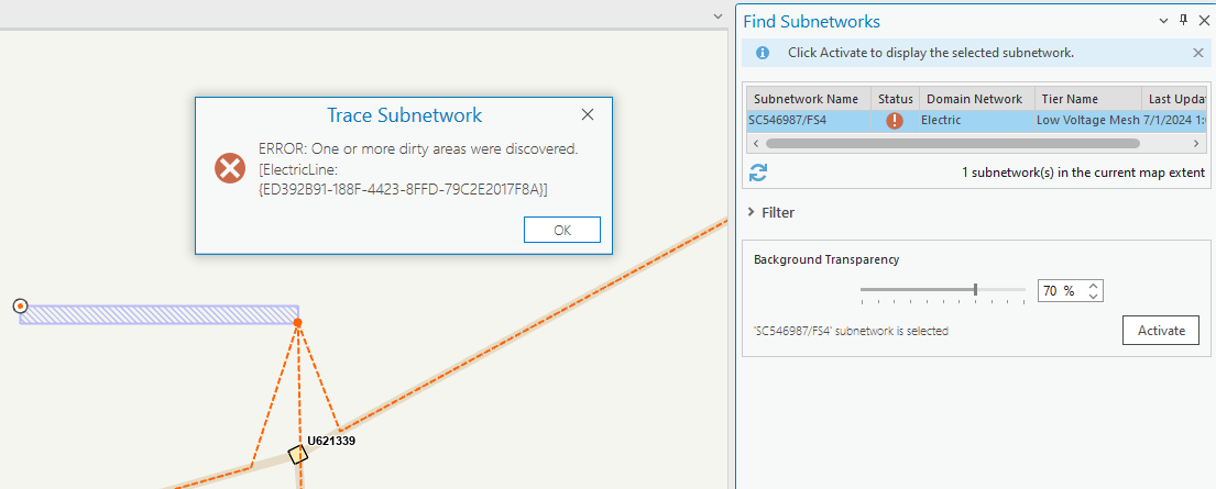

ArcGIS 3.1.5 Error – text within the error message is not selectable and can’t be copied.

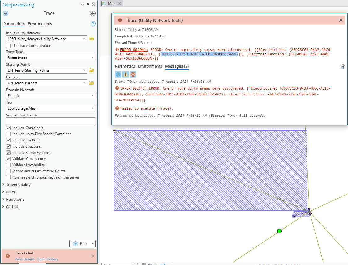

ArcGIS 3.1.5 – Trace via Geoprocessing tool.  Error message displayed allows text to be selected and copied

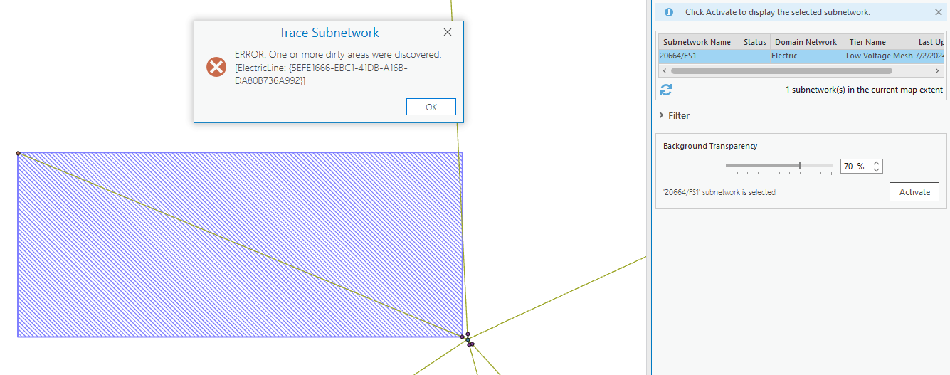

ArcGIS 3.1.5 – No company Config, data added as Subtype Group Layer and Utility Network added through Portal.  Same type of Error message – can’t select the text
