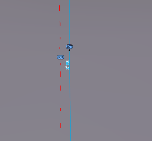

Example 1: Is Connected is True on Both of the following features and are part of subnetwork. However the system junction created remains.
Here is the record in the system junction system table no archive record created and original record not given delete date and flag, even after everything has been connected properly and validated:

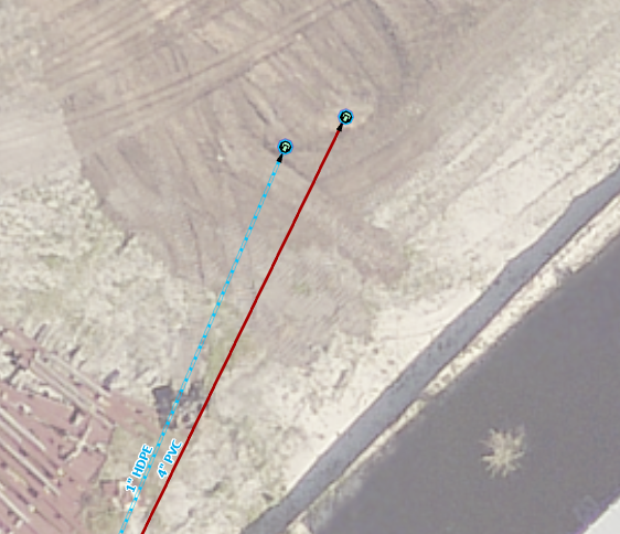

Example of another system junction in the same area but was archived/deleted correctly after fix and validate:

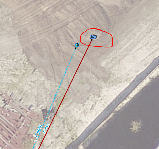

Example 2: System Junction remains even after the line is deleted:
Above System Junction records no archived created after fix and delete of line:

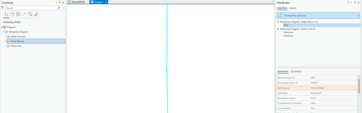

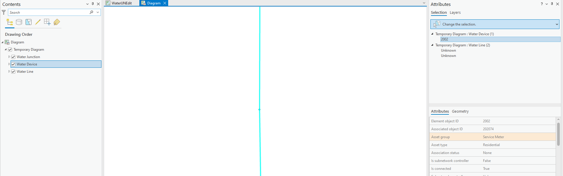

UN Basic Diagram result has no system junction points shown. Verifying connectivity is okay:
