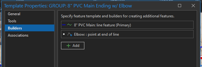

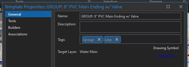

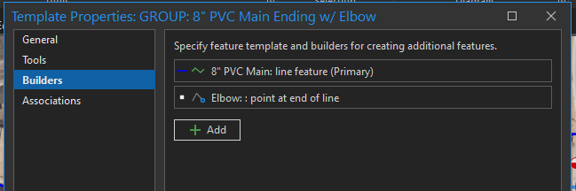

Hi everyone,
We have recently migrated to the utility network and have several group templates setup for our editing processes.  We are having problems troubleshooting an issue where ArcGIS Pro is not recognizing the fact that we have selected a different group template to use.  For example, a user may have successfully used one group template (8" water main ending with an Elbow) and then wants to switch to a different template (8" water main ending with a valve).  When the user draws using the second template, the first template is actually drawn. That is just one example, but I could spell out numerous examples between other templates where we have this problem.  Has anyone else come across this or is this a known bug/issue?
