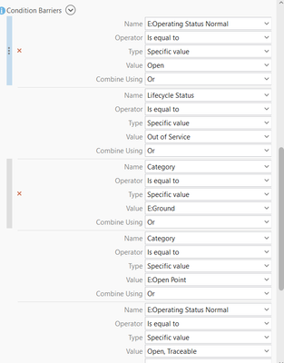

@KokilaM - we got past this by setting a traversibility filter in the subnetwork definition to stop at a subnetwork controller.

@KokilaM - so what's happening here is that Distribution Tier Subnetwork A and Subnetwork B have the same "valid" objects. So subnetwork A continues and overlap subnetwork B.
Subnetwork A needs to stop at the point where Subnetwork B begins i.e the feeder circuit breaker.
To do that, add another condition in the subnetwork definition.
ISSUBNETWORKCONTROLLER  = YES
After that the SUBNETWORK A should stop at the Circuit breaker which is subnetwork controller of SUBNETWORK B
