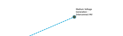

  • Device: Medium Voltage Generation / Interconnect MV
  • Line connected to itMedium Voltage Underground Conductor / Three Phase MV

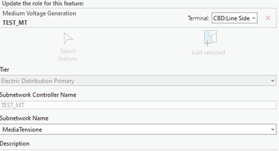

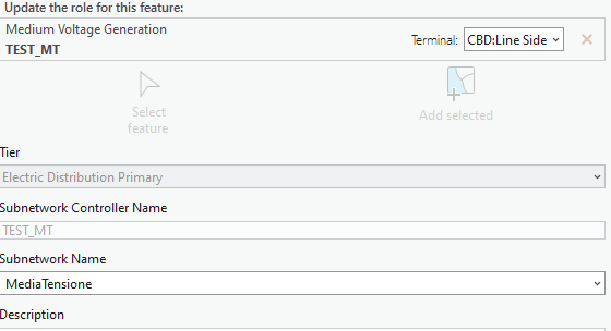

  • Terminal connection: CBD: Line Side
  • Controller:

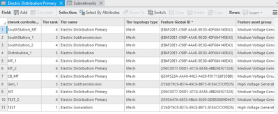

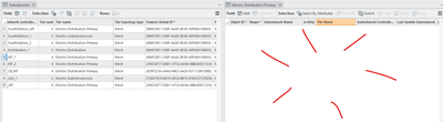

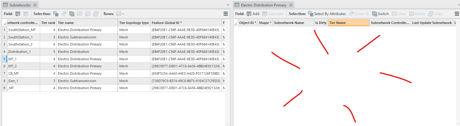

When I run the "Update Subnetwork", the tools runs correctly but the SubnetLine FC (and the corrisponding layer in the attribute table) is empty.
The "weird" thing is that if I click the "View Subnetwork" pane I see all the tests I've done and all the Subnetwork controllers I tried to set.
