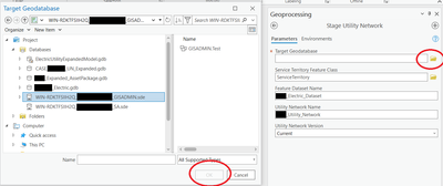

Trying to use the "Stage Utility Network" tool I am unable to select a Target Geodatabase.    I have created a SQL*Server database and used the Create Geodatabase GP tool to create the geodatabase.  I've created a user that has the ability to create Geodatabase objects -- I've tested this by creating a feature dataset and a feature class owned by this user.
I've got an SDE connection file that points to this database which has the credentials of the user that can create Geodatabase objects.
I can connect to this Geodatabase within the project I'm using to run the "Stage Utility Network" tool
I can supply the Service Territory feature class and other parameters the tool wants.
But when I try to browse for the Target Geodatabase using the SDE connection, the "OK" never enables.

Can you post a screen shot?  What version of the ArcGIS Pro?

Thanks for the reply.    Here is what I see.  No matter what type of connection file I choose I cat' get the 'OK' to enable when selecting a target geodatabase.
Any suggestions would be much appreciated.
Ed

Might be one of those odd things with how you navigate to the file.  The SDE file needs to be on the right select.  The left side is a navigation.  So click the parent folder of the SDE file on the left and select the connection on the right.
EdwardBlair
OMG.   I was right in the beginning about missing something stupid.    Picking the SDE connection from the right side of the dialog works as expecting.
Thank you *very* much for pointing this out!
