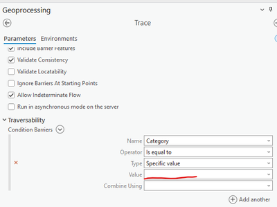

gis_KIWI4
John has explained this perfectly.
I will just add to this by giving an example of how we do it.
We have all our isolation and protection devices assigned with a network category so when it comes to tracing it can be easily used within the query.
The alternative to this would be
SourceID=9 AND ASSETGROUP=5 AND ASSETTYPE=1
OR
SourceID=9 AND ASSETGROUP=5 AND ASSETTYPE=2
so on for all devices you want to use as barriers/filters.
This can get quite complicated if you want to include a multitude of devices like fuses, reclosers, circuitbreakers, etc.
