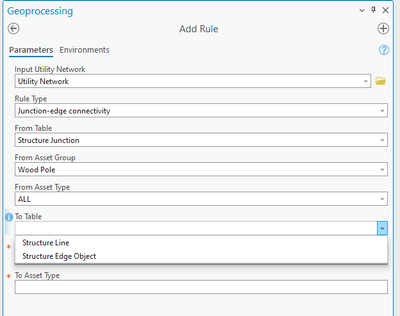

@shildebrand  - are you trying to snap the domain network to structure network?
As far as I am aware the snapping only works if there is a rule for it and that you cannot create a Junction Edge Rule between Domain and Structure Network.
