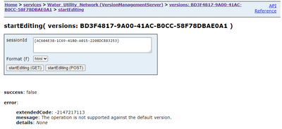

I just tested this out locally, and in order to access the version URL you need to remove the curly braces. If I forget to remove the curly braces, then I get the error you see above. Another important thing to remember is that you can't undo or discard edits in default so you shouldn't need to start/stop editing. If you try to start editing in default you will get this error:

This is it - there should be no curly braces on the URL. Also I've sorted out that I should create version first and then work with it (this step in the video is missed).
