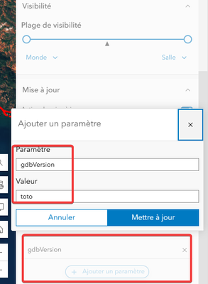

You can also try using the gdbVersion parameter (I assume the Branch widget and field map versioning settings use this parameter internally).
For example, you can add this parameter to each layer of your web map:
Or directly in the REST URL when adding the service (https://serverName.esri.com/server/rest/services/serviceName/FeatureServer/4?gdbversion=versionName)

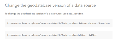

In Experience Builder, if you use the branch version widget, you can also set the version in the URL parameter :
See here : https://doc.arcgis.com/en/experience-builder/latest/build-apps/url-parameters.htm#ESRI_SECTION2_61C4...
