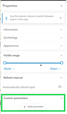

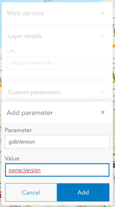

I haven't had the opportunity to test this for your exact scenarios, but with the latest version of Map Viewer in ArcGIS Enterprise 10.9.1 (i.e. formerly Map Viewer Beta) you can specify Custom Parameters when adding a layer from a URL (see Add layers from a URL).
When you do this, the parameter is appended to all requests to the specified resource.  So theoretically, you could add gdbVersion as the parameter and the named version as the value and it should target that version for ArcGIS Server requests.
You can add/update custom parameters for layers added by other means (e.g. browsing layers) by opening the layer properties.

JustinMuise
Hi MoelSaket,
I believe what Craig explained is accurate. You should also be able to add your layer with the URL having the gdbVersion parameter. For example, see below:
https://serverName.esri.com/server/rest/services/serviceName/FeatureServer/4?gdbversion=versionName
Thanks!
Justin
DasheEbra
Hi @JustinMuise,
thanks a lot  for your help, it works well.
