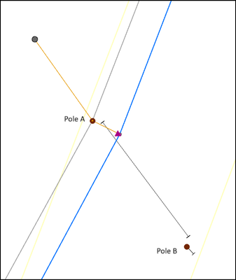

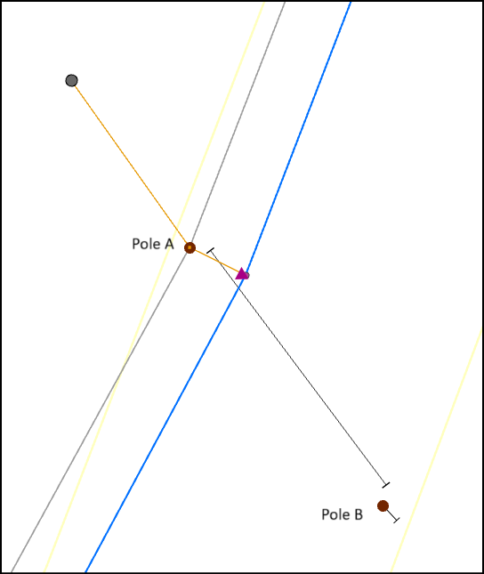

Hello Community,
Is it possible to propagate SUBNETWORKNAME thru the Structure Network?
For example, a Pole has a transformer attached and so inherits SUBNETWORKNAME "1155". Is it possible to propagate SUBNETWORKNAME from StructureJunction:PoleA to snapped StructureLine:SpanGuy to another snapped StructureJunction:PoleB?
  • A Junction-Edge rule does allow the Pole to connect to SpanGuy.
  • I do not see how to accomplish this by setting Subnetwork Definition.
  • Illustration:
RobertKrisher
This is a currently known limitation of how subnetwork management handles propagating subnetwork name. If this is important to you, please log an issue with support so they can get you attached to the corresponding bug.

Joel_EWEB
Got it, thanks Robert.
