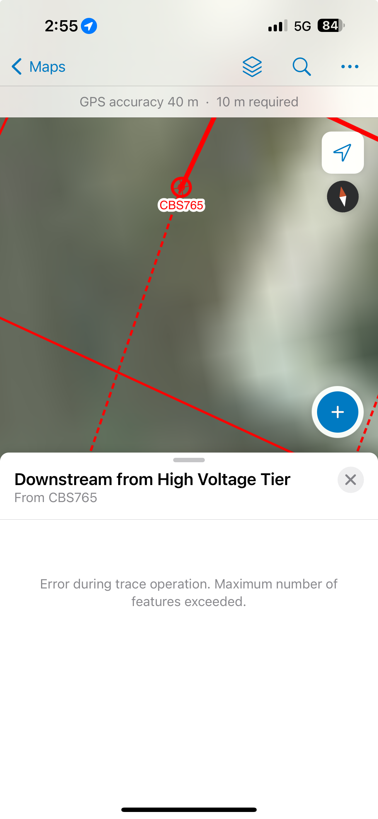

Has anyone encountered this?
is there a setting I can change to get this to work?
it works when I select shorter “trace routes” which I assume select a lesser features than the case above.
UN version 6
Enterprise 11.1
Thanks, any help is appreciated:)
RobertKrisher
Due to performance issues with the Maps SDK, Field Maps by default limits selection results to 500 features. In the next release of Field Maps, this value will change to 1000 features. If needed, the max trace results value can be increased through a mobile device management (MDM) parameter.
Other trace output types, like aggregated geometries and functions, are not limited to a feature count in this way. This only applies to selections.

Hello, have you tried to increase the maximum number of records returned by the server in your UN service ?
https://enterprise.arcgis.com/en/sites/latest/content/server-configuration-details.htm
Or better --> you should modify your named trace in order to return less features, so that it is usable in field maps

Is this issue already solve??? We are facing the same error when tracing the Utility Network. I'm using IOS Version 18.3.2.
RobertKrisher
