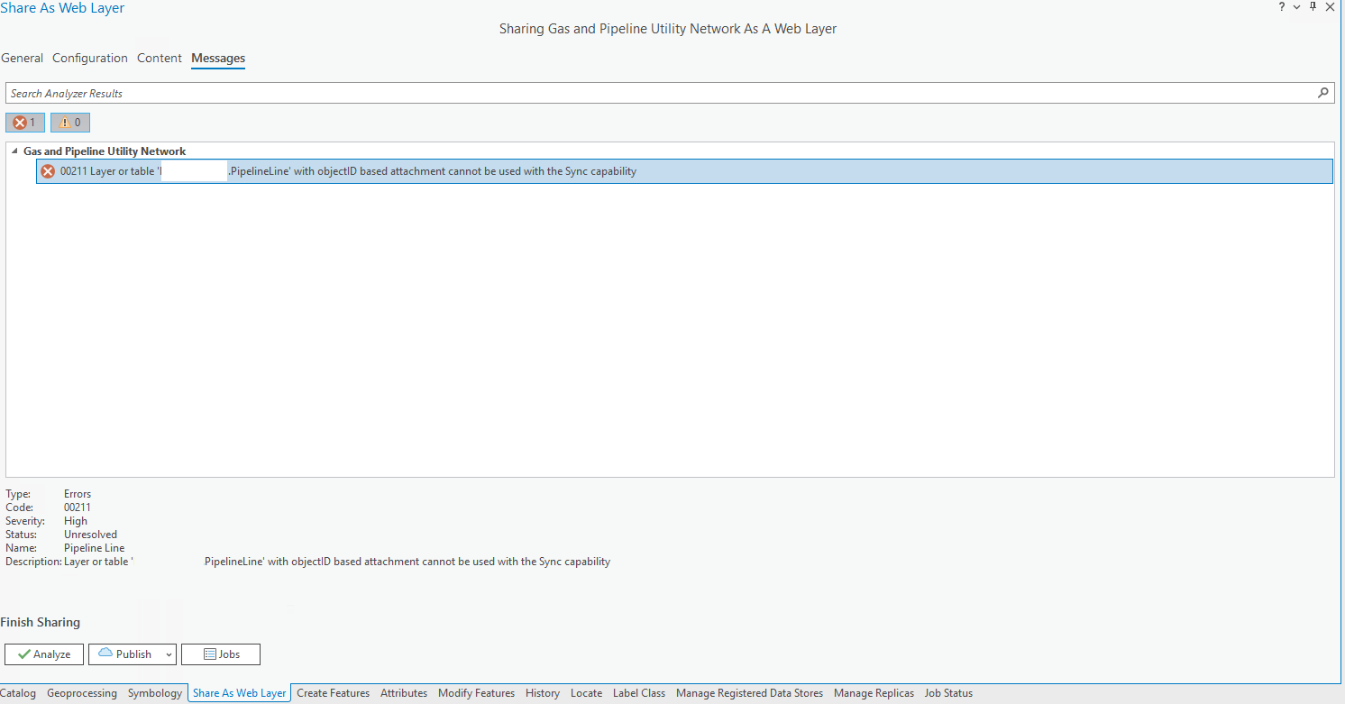

Hey everyone, I am having trouble publishing the Utility Network map. I am receiving the following error: "pipeline objectID based attachment cannot be used with sync capability". Is there a way to fix this without us having to disable attachments and lose +20k attachments?
MikeMillerGIS
Esri Frequent Contributor
This will do it for you -https://pro.arcgis.com/en/pro-app/latest/tool-reference/data-management/migrate-relationship-class-tool.htm
