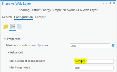

3. Confirm that you are updating the max number of domain records returned to over 10,000,000
I hope this helps!
