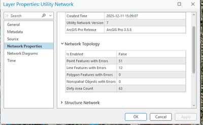

I am getting an error when trying to update subnetwork, it is saying to enable topology. As I go to enable topology, it returns that the topology is already existing. I've disabled and reenabled it against the UN service but in my network properties, it is showing Is Enabled still as "False". Anyone know what this issue is?Joshua_Moreno_0-1767382316799.png

@Joshua_MorenoAre you doing this in a local geodatabase or an enterprise geodatabase? Can you show a screenshot of enabling the network topology succeeding (with the parameters) and update subnetwork failing?
If you're enabling the network topology against an enterprise service, its possible you're doing this in a version other than default. Its also possible that your enable network topology GP tool is set to "only generate errors", which will create topology errors but not enable the network topology for tracing.

Hi Robert, I was doing this in an enterprise geodatabase. The same thing happened again yesterday but I followed the steps above for fixing posted by Venkat. I believe what may be happening is that I wasn't logged into portal within my Pro session so when trying to post edits or update topology/subnetwork, it provided an error that made the geodatabase/service out of sync thus turning off the network topology.
I did ensure the only generate errors param was disabled. Do you think what I had mentioned above might be the cause? I can try to replicate again and see if this is the issue. I work in a VM so my login isn't persistent and I always forget to login to the correct portal/account.
