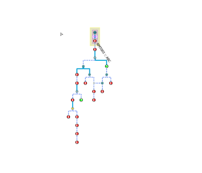

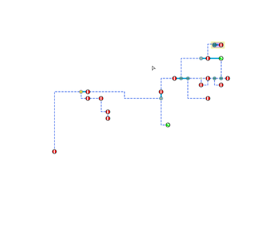

First, I think the symbology you are using in your map is just the default simple, which means you aren't using a map where you have defined symbology.
Second, I'm guessing the trace you are using is returning all features, transformers, etc, which will make the diagram very congested.
Here are two images.  The first one is the diagram produced by the diagram code I sent you.
The second image is from a diagram template named Electric Distribution Circuit Switching.
The trace I used is below and I placed the start point on the Circuit Breaker for RMT003

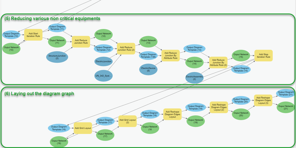

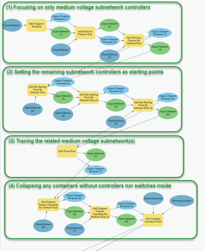

AnneYvonneBlin
@sonj
I guess the NapervilleElectricSDKData.gdb geodatabase you are talking about is the one coming with https://github.com/Esri/arcgis-pro-sdk-community-samples/releases/download/3.3.0.52636/CommunitySamp...
In this case, please have a look to the NapervilleElectricSDK_CustomTemplates toolbox referenced in the related project (Data\SDKSampleNetwork\SDKSampleNetwork.aprx).
The CircuitSwitching_FromMediumCB model builder under this toolbox is the one we used to configure the template of the same name, CircuitSwitching_FromMediumCB.
This template allows to generate diagrams focusing on critical devices such as switches. It is configured to start diagram creations from medium voltage subnetwork controllers that users select as inputs (that is, from medium voltage circuit breakers, medium voltage transformer banks or low voltage network protections). Then it uses these inputs as starting points to trace the related medium voltage subnetwork. Next, it chains a sequence of diagram rules to simplify the diagram graph and so mainly focus on the critical devices.
In details, diagrams based on this template are configured to be created thanks to the following diagram rule sequence:
(1) A set of Remove Feature rules so that, among all the potential input users provide for the diagram generation, the diagram builder keeps the only medium voltage subnetwork controllers (= medium voltage circuit breakers, medium voltage transformer banks or low voltage network protections).
(2) Set Starting Point rules to set each remaining medium voltage subnetwork controller as starting points
(3) A Trace rule configured to run a subnetwork trace from those starting points
(4) Add Diagram Feature Capability rules to flag any switches at the frontier of multiple subnetworks and subnetwork controller from being collapsed and a Collapse Containers rule to collapse any other structure junction and assembly containers
(5) A set of Reduce Junction rules to reduce any structure junctions, any electric junctions, any system junctions, any electric devices excetped subnetwork controllers and switches, and any electric assemblies excepted siwtch banks as much as possible
(6) The diagram graph resulting from all these rules is then laid out using to the Grid layout, then applying a few Reshape Diagram Edges operations.
