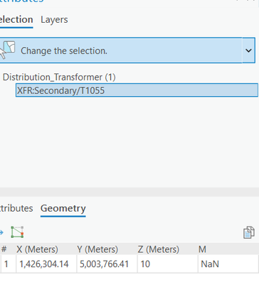

@TanyaWright1 - much simpler with a point. Use the "Calculate Field" option on the Shape Field.
Use the following arcade operation.
var geom = Geometry($feature)
var new_point = Point({
    x: geom.x,
    y: geom.y,
    z: 0,
    spatialReference: geom.spatialReference
return new_point
Tried it out on a test dataset, where z = 10
Hope this helps.
