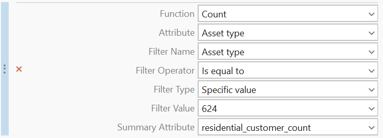

I'm working with an electric UNv7 in an MGDB using Pro 3.5.5. I am attempting to add a summary attribute to my subnetwork definition that provides a count of how many different types of service locations are on each subnetwork (i.e., residential vs commercial). However that differentiation is at the asset type level and when i attempt to create a new summary attribute using Asset Type I get "Error 000800: The value is not a member of <Unknown>.
Comparing using the Asset Group vs Asset Type as the attribute, i notice that the filter value changes from free text to a drop down, and with asset type the drop down only includes an Unknown value. Is this potentially the tool having an issue aggregating the possible asset types across all the asset groups?

You should filter using network categories instead of asset types. It's easier to configure, provides more flexibility, and performs better.
The issue is likely caused by the data model you are using, also remember that asset types are not only not guaranteed to be unique in the entire utility network, but they're not even unique within a feature class (so specifying a particular code could provide an inaccurate result if that code is used on a different type of features). For all these reasons, and the ones listed in the first paragraph, create and assign a network category for this.
