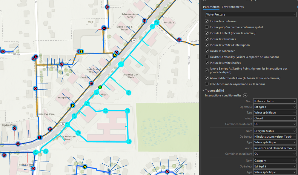

Example, here a "normal" isolation trace in the Water Pressure tier, that finds closed valves (north) :
normal tracenormal trace

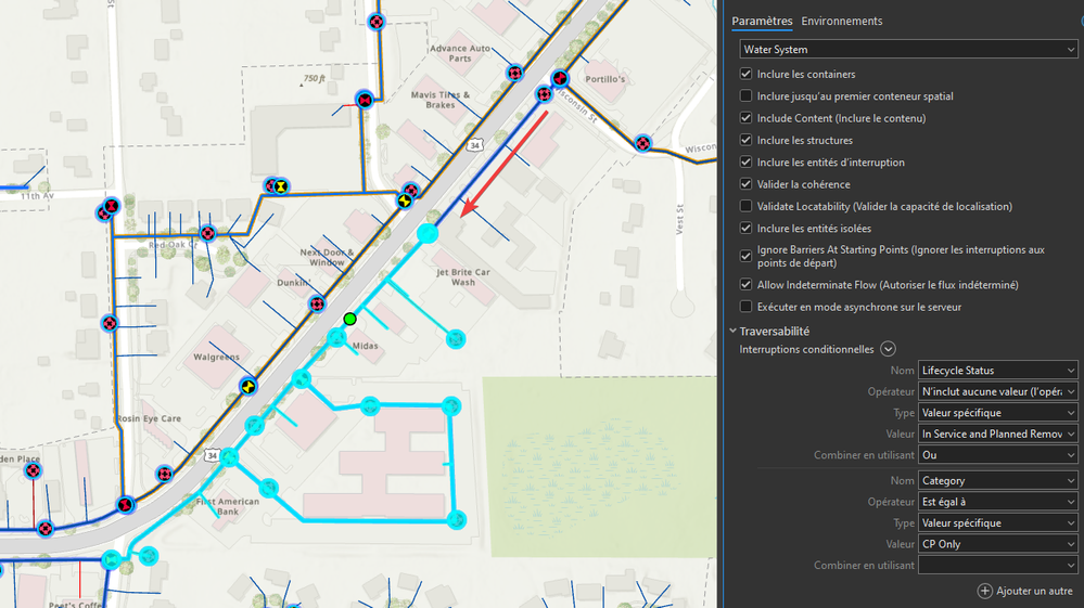

And here is the same, at the Water System tier, without the Device Status barrier. The first open valve is detected instead of the closed one, a portion of the outage zone is now unimpacted :
New trace without closed valvesNew trace without closed valves
