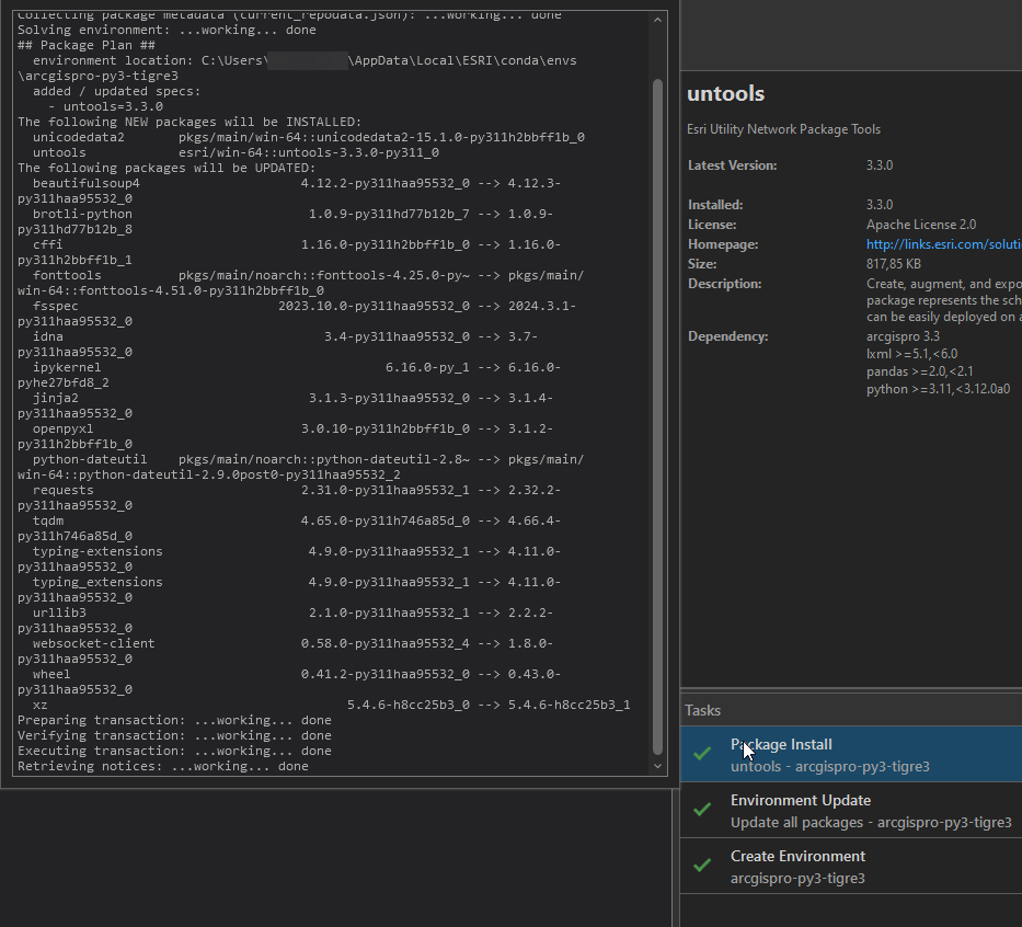

after upgrading to Pro 3.3, I created a new python clone environment.
After that, I can create a GIS connection in python using arcgis.gis.GIS(**PORTAL)
But, then, I installed untools and it broke the GIS connection.
Now I have this error :

The issue is with the requests library. conda updated this package during the installation of untools (despite untools not even using it).
You need requests >=2.30.0,<2.32.0
I was able to reproduce this and confirmed that downgrading to requests 2.31.0 resolved it.

Thanks Paul,
pip install requests==2.31.0 did resolve the bug.
Weirdly, conda install requests=2.31.0 does nothing...
